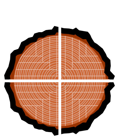

If any of you wood guys have a diagram that would show how the Mill should quarter and cut please PM me with it so I make sure it is done right. They don't do alot of that down here I would expect.

Don or Paul, I need some instructions on how to instruct my mill man to hack this thing up, if you know, let me know.

Mike, if you split a log through the center it is halved, if you split it again at 90 degrees to the face it is quartered. You need to cut to the center wherever it ends up in the tree, basically.
That is quartered log. Now for quartered billets you cut off the faces of that quarter log, with an occasional adjustment to get the grain perpendicular to the face again.
IF you were splitting Spruce, you'd just split billets that were wedge shaped. But since you are dealing with a hardwood, you need to saw to get back on quarter.
lllllllllllllllllllllllllllllllllllllllllllll
looking at the end of a billet the grain runs vertical if laying flat.
if your cuts look like this they are going off quarter, still very usable but less quartered. Around 45 degrees skew and folks call it rift sawn.
flatsawn wood is basically with the grain laying flat, just imagine the above laying over twice what you see above and you have flatsawn. Flatsawn, while not preferred in tonewood is acceptable for backs more than sides. We really want the sides to be as quartered as possible, for ease in bending and strength.

Thanks for the Info Bruce Dickey, the first part seems pretty simple, it is from there that I get a little lost.
I have PWoolson sending me some additional info and I have solicited the assistance of the Zootman to assist as well. I will more than likely have the mill man talk directly with BobC and get sizing and all on track. They can have a Zoot conversation since they both speak that language. I will just be the photo man.

I would like some also, if everything all pans out. I crave Walnut! I also sent you a diagram of QS wood...

Mike, here you go. I hope you can make sense of it. You'll notice that if the cuts are made straight, like my illustration shows, the ends of the cuts will be further off quartered. This is what BD was explaining. As you get way out, almost to the end of the wedge, the cuts will be quite rift sawn (more than 45?) which won't hurt much because they will be so small you can't use them for backs/sides anyway.
Hope this helps. Paul
